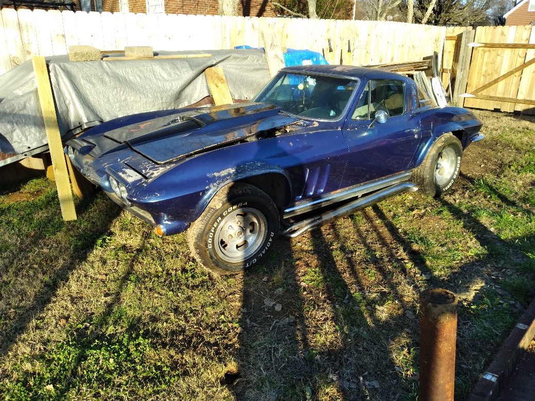

I should have started this thread a while ago. All the c2’s popping up on here got me going on it. I bought the car from a member here last January(2023). This is what it looked like then.
65 corvette, RS chassis, LS3, TKX
